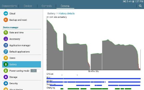

It lasts a very good amount of time about 7 hours I will post the percentages for you to see
I am pretty sure it is the system reading the battery level that it is off but I have no idea how to reset it or reconfigure it
I'm not so sure...you have some wakelock issues. Have you tried a reboot? Might be a stuck app.

Yes that's when it jumps back up to a higher percent every time I restart it is shows the true percentage and it isnt any rogue apps because there are no apps on the tablet at all I factory data reset it and didn't download a single one
