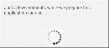

Also I been getting this message lately when launching apps (random apps, not always from the same one)
"Just a few moments while we prepare this application for use..."
It can appear from launching gallery, to texting to angry birds... its completely random.
Is there a solution to this? It loads for a while, I end up force closing usually...

I been getting this sporadically too. I have no idea what it is.

I kept getting the same "getting the app ready" message sporadically but just kept pressing the home button and it would go away fast. Instead CM10.2 and never had the issue again.... Maybe it was some crap Verizon put on the phone
Well I tried the wipe the cache partition and that "Just a few moments while we prepare this application for use..." still happening.... Not sure what to do.

Had the same ...setting up app... thing that kept coming up. This afternoon I was in a place with no Wifi or cell signal and the same box gave an error message and a phone number. I googled the phone number and it was Verizon's, so I think the software that keeps doing this is BackupAssistant+ or whatever the bloatware backup thing Verizon foists off on you. Anyone know a way to shut this down without rooting?

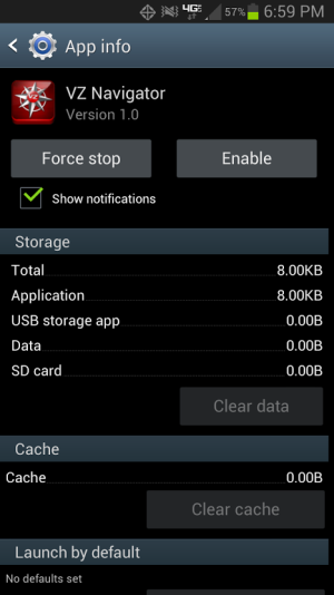

I deleted and disabled the VZ Navigator. That solved my keyboard lag issue. Keyboard seems to work fine now.
The other problem could be related to the backup assistant plus. I know exactly what error message with a phone number you talking about. I got that today too and then the backup assistant plus asked me to enter my password.
Unfortunately you cannot Disable that app from within the Application manager - the best that you can do is go into Settings -> Backup Assistant Plus (under the Accounts heading) and uncheck all of the items - then there's nothing to backup (and as far as I can tell the app never runs).
