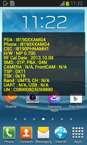

i just got back my s3 mini from the service centre after repair of signal drop issue. now when i turn it on i get an annoying translucent window with yellow text that does not go away. also, my power button menu does not show up nor does my device lock when i press the power button.... please help! (see screenshot)

It sounds to me like they loaded some bogus firmware on there, or perhaps left their testbench firmware on there. I'd take it back, or use the Kies software on your PC to reload the stock firmware.
Here's an overview of what to do:
- if you don't already have the Kies software installed on your PC, download it (just search Google) and install it. The first time it runs it'll update itself to the latest version so make sure you run it once before proceeding.
- put your phone in Download mode: with the phone completely off, press and hold the Volume Down and Home and Power buttons simultaneously, and release them all when you see the Samsung splash screen
- connect the phone to your PC with the USB cable that came with the phone
-- if you've never had the phone connected to your Windows-based computer before, you'll see messages about installing drivers, etc - just wait until this is done (may take 5 or 10 minutes) [I don't know what happens if you have a Mac - it probably just works]
- in the Kies software, select the second item in the Tools menu and just follow the prompts to enter the model number (in CAPS) and IMEI/Serial Number (both found under the battery - it's ok to remove the battery at this point)
- the Kies software should start downloading the correct firmware for your phone from the Internet; once that's done (depending on your Internet connection speed) it'll begin downloading that to the phone (this probably takes 10 minutes or so)
Sent from my rooted, debloated, deodexed Sinclair ZX-80 running CM 10.2 using Tapatalk 4

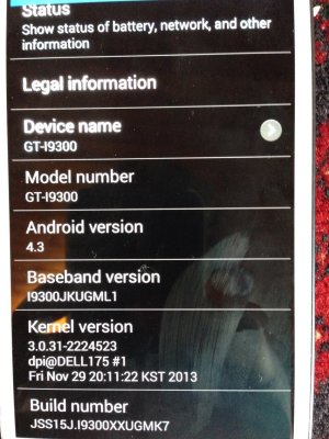

Yes, it was displaying the same information overlay. I used Kies, but it doesn't recognize the phone and I tried ODIN v3.09. After it finished its work the problem is still there. Is it very important to have ODIN v3.07?

I'm not sure why you're still getting the overlay - that should have been taken care of by flashing the stock firmware. There's nothing plugged into the micro-USB port is there? (Silly question but I had to ask; that's the only other reason I can think of that the phone would be displaying diagnostic information.)
Edit: be sure you boot into Recovery mode and wipe the system cache, and perform a Factory Reset while you're there.
BTW, does that overlay only appear on the Home screen?
And is your Power button functional (the earlier poster mentioned some problem with the button)?
Edit 2: can you post a screenshot of the overlay? I'm just curious about the information. (To capture a screenshot, press and hold the Home and Power buttons simultaneously, and release them when you see the screen flash with the white border.)
