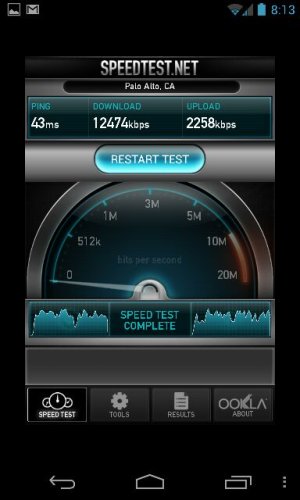

First Speedtest (before OPs instructions) had me at 6.7mbps down 0.34 up.
After, I had 13.64mbps down 1.05 up.
(Only getting HSPA 10)

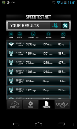

Nice find. Definitely increased my speeds. Only have hspa 10 at home, only problem is my ping times went through the roof.
Bottom two are my speedtest results before I enabled roaming. Middle three are with it on. Top one is my awesome verizon dsl speeds lol.
