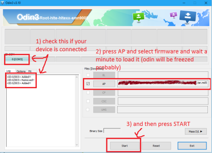

2) Run 'Odin3-v3.10.6.exe' as administrator.

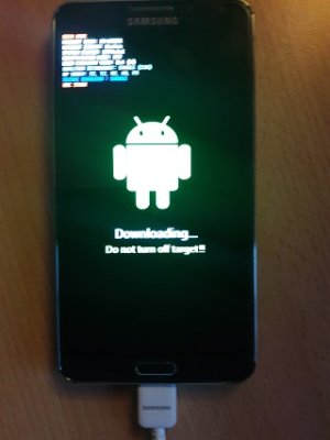

3) Reboot your phone into download mode and plug in your PC - see picture > 1111.jpg
4) In Odin press AP button and select downloaded firmware (.md5, not .zip) and then press START button.
5) Just wait 15mins and do not unplug your phone until in odin will not be 'DONE'.
