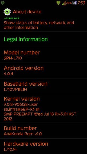

Here is what I'm running.

Aww man. Your running the anakonda rom. Now I'm not going to help you. It's too good a rom to leave.
You have been running a deodexed rom for awhile now (anakinda is a deodexed rom). Deodexed roms are a lot easier to make mods for. Most developers prefer them over odexed because they are easier to work with. But if e you are just going to run it stock rooted, you might as well flash the odexed. It will likely boot a little faster and may be a bit smoother but I doubt you will notice.
