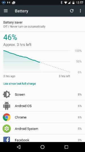

Well went for a run today, and no crash! The temps were in the low 40's to high 30's. I turned off battery saver and so far it hasn't crashed! So far so good!
Out of curiosity, did you previously turn Battery Saver ON before runs?
I always left it on. When it would turn on I would charge the phone. Either that, or I would charge somewhere in the 20's percentage wise.

I've been having this problem since Nougat. Lucky for me the phone never shuts off until I hit battery saver which I have set up to come on automatically at 15%. So today I decided to shut off battery saver and the phone stayed on well past 15%. It ran down to 5% and then I plugged it back in. So I've now set up battery saver to kick in at 5%. We'll see if this changes when the random shut off happens.
