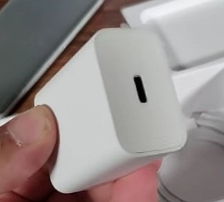

Sheesh, I have no idea what my official Pixel 3 charger and/or cable look like!!! They probably joined a pile of cables and chargers. Do they have Google logos on either item?
Quoting myself - found an unboxing Pixel 3 video and captured and image of a rather generic adapter although rather than the standard USB-A connector on the charger is has a USB-C connector.
