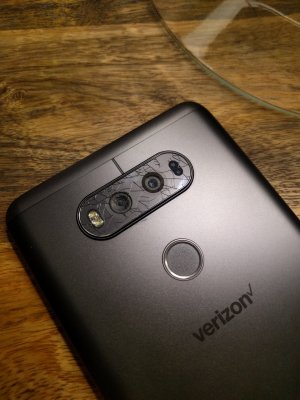

Here's your photo. Good luck finding that "impact point".

I would contact LG if I was in your place. It won't hurt to ask. They may question the mark just below the camera lens on the left, though.
I would agree. The glass itself doesn't show an impact like the others I've seen, but any sign of physical damage/abuse is grounds for them to deny a warranty claim. This wouldn't be specific to LG, but manufacturers in general.
I see one small spot over the LED flash wear something might have pressed up against it. It doesn't take much to shatter the glass...just something pointy with very light pressure. A friend of mine who works at Verizon tested it on several different DOA phones both LG & Samsung and you wouldn't believe how fragile the camera glass it. The edge or point of a key easily shattered the lenses in every case. Tempered glass can break on its on though if they are tiny impurities in the glass. It happened to me on my storm door glass panel that was sitting in the attic.
