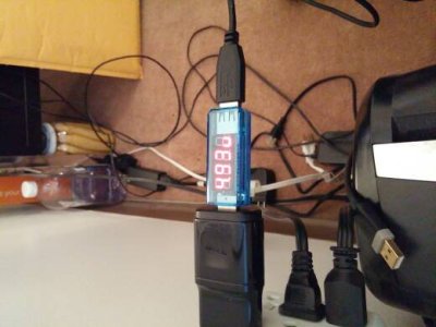

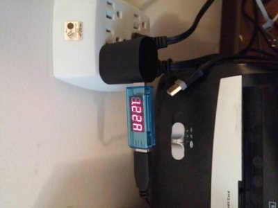

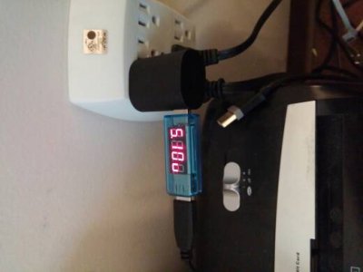

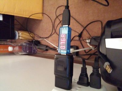

So after being frustrated about my G3 taking forever to charge I decided to to some investigation and found some disappointing news. It was bad enough that my brother's MOTO X has Quick Charge 2.0 so I wasn't happy at all about my G3 taking forever to charge. So I took to Amazon to purchase a USB volt meter to test the charger that came with my LG G3. While it is rated at 5.0V and 1.8A I was disappointed to see that it was only outputting 4.93V and 0.76A. I then tested the Nokia AC-60U charger that came with my Lumia 1520 and got much better results. It was outputting 5.10V and 1.22A while being rated at 5.0V and 1.5A which was a huge improvement over the stock G3 charger. I am now using the Nokia charger to charge my G3 and I am now getting noticeably MUCH faster charging times. So if your LG G3 is charging slowly get a better charger but beware as the Samsung charger which came with my Galaxy Tab Pro 10.1 which was rated at 2.0A only tested at 0.86A on my tester. I'm just going to stick with my Nokia charger since it's kicking **** charging my G3. Hope this helps you guys who are having issues charging your LG G3....
