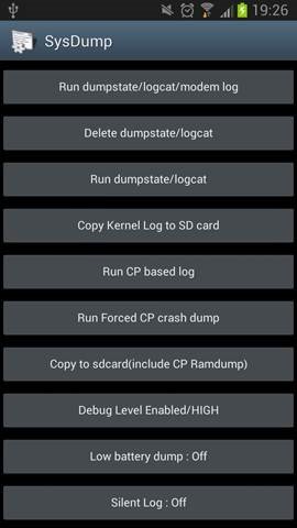

Can you try this sequence of keys on your Verizon Samsung Galaxy S3??
Samsung is trying to get us to dump the log so they can look at what the email app is doing.
*#9900#
when we tap this on the keypad as if we were dialing it does nothing.
The way to capture log.
1. please reproduce the problem.
2. Please go to phone dial and press *#9900#. (Please do after meeting this issue as soon as possible.)
3. You can see the following screen
please choose ?Run dumpstate/logcat? . it is 3rd item
4. After pressing ?Run dumpstate/logcat?, it will take time to show completion message.
after finishing it, please press ?Copy to sdcard(include CPRamdump)?. it is 7th item
5. When you connect your device to your PC with USB, you can know cell phone has the ?log? folder.
6. The ?log? has the debugging information. Please send Samsung whole ?log? folder for investigation.
Let me know what your S3 does attached is screenshot of what Samsung says it should do.
Our S3 won't go to this screen after following above directions.
