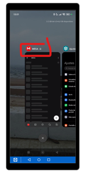

I have a Xiaomi Poco (I've attached screenshots so you know the model better).
My problem is with the Mega app (a cloud storage service like Dropbox or OneDrive).
I noticed that if the app is in recent apps, the app sync works. Now, when I remove it from those recent apps, it stops syncing.

They told me that some devices, like mine, consider closing "Recent Apps" as completely closing the app, even if I have added it as a blocked app so it always stays open.
Following this response, I asked if anyone else had the same problem and what solution they had adopted. However, much to my regret, they couldn't offer me any alternative.
For this reason, I'm writing to ask if anyone can provide me with a solution, even if it's just installing an app, to prevent it from closing if I make a mistake and delete it from my recent apps.

Look, I'm attaching two screenshots so you can see that I've disabled the app's battery saver and allowed it to auto-launch in the background.
Isn't there a way to prevent this behavior through an app?

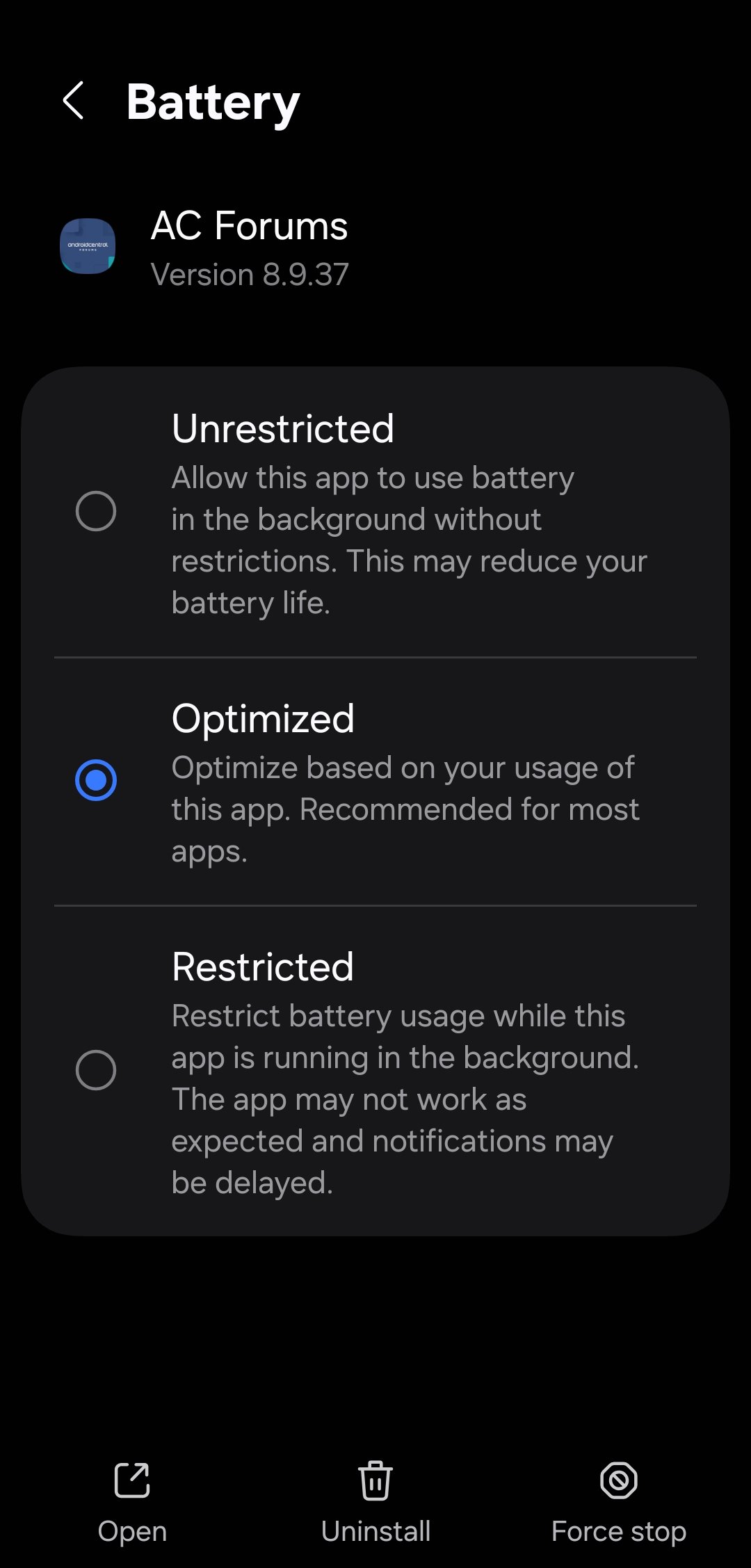

You can try locking it to your recent apps that way it doesn't get cleared out to make room for other apps , also try long pressing the app then tap info>battery set unrestricted I'll show an example in my screenshot
The only other suggestion I can say is clearing the app launcher Data then force stop it Incase it's glitching but it will reset all your home screen customization.
