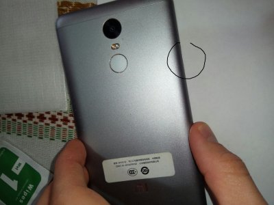

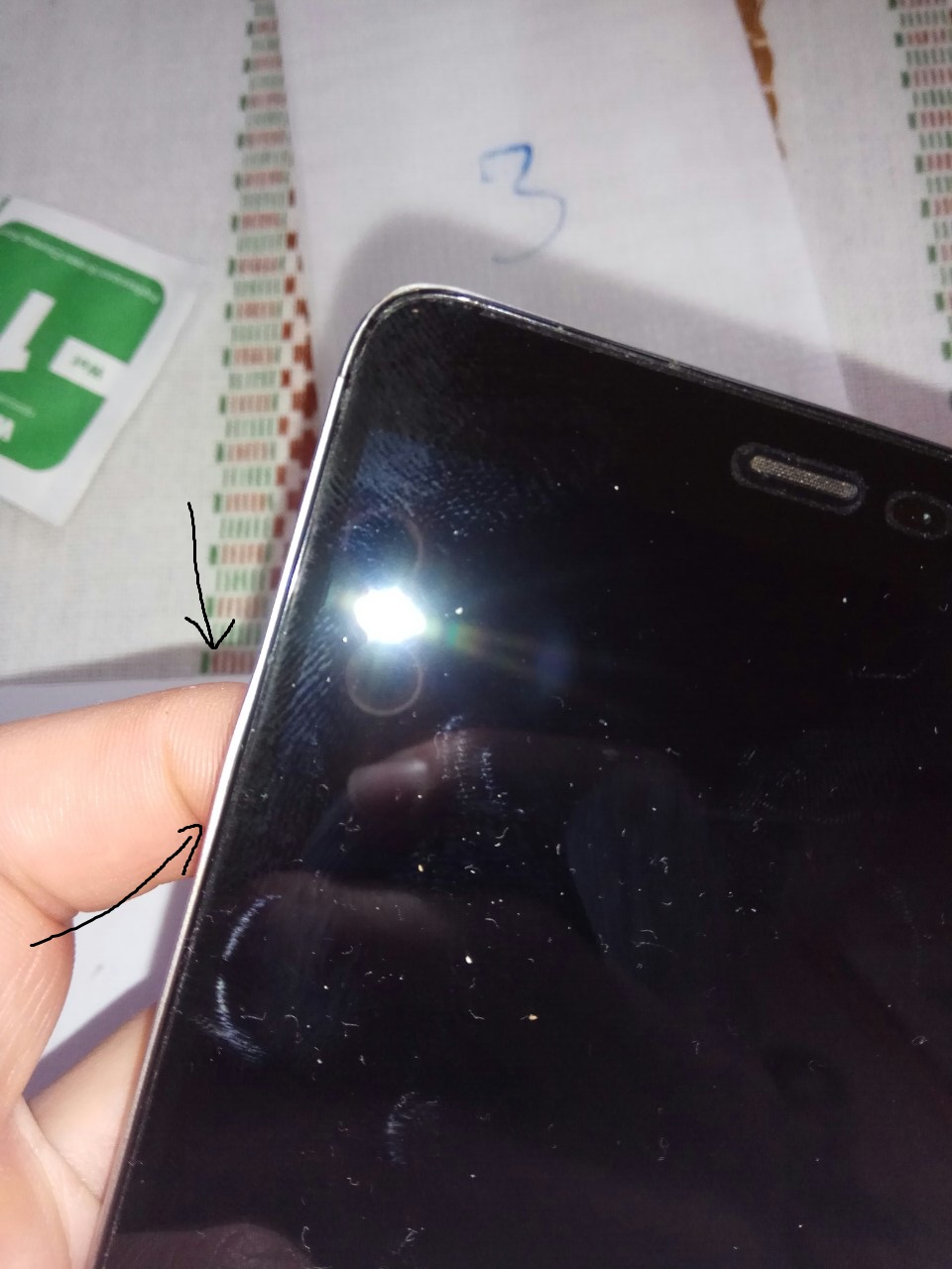

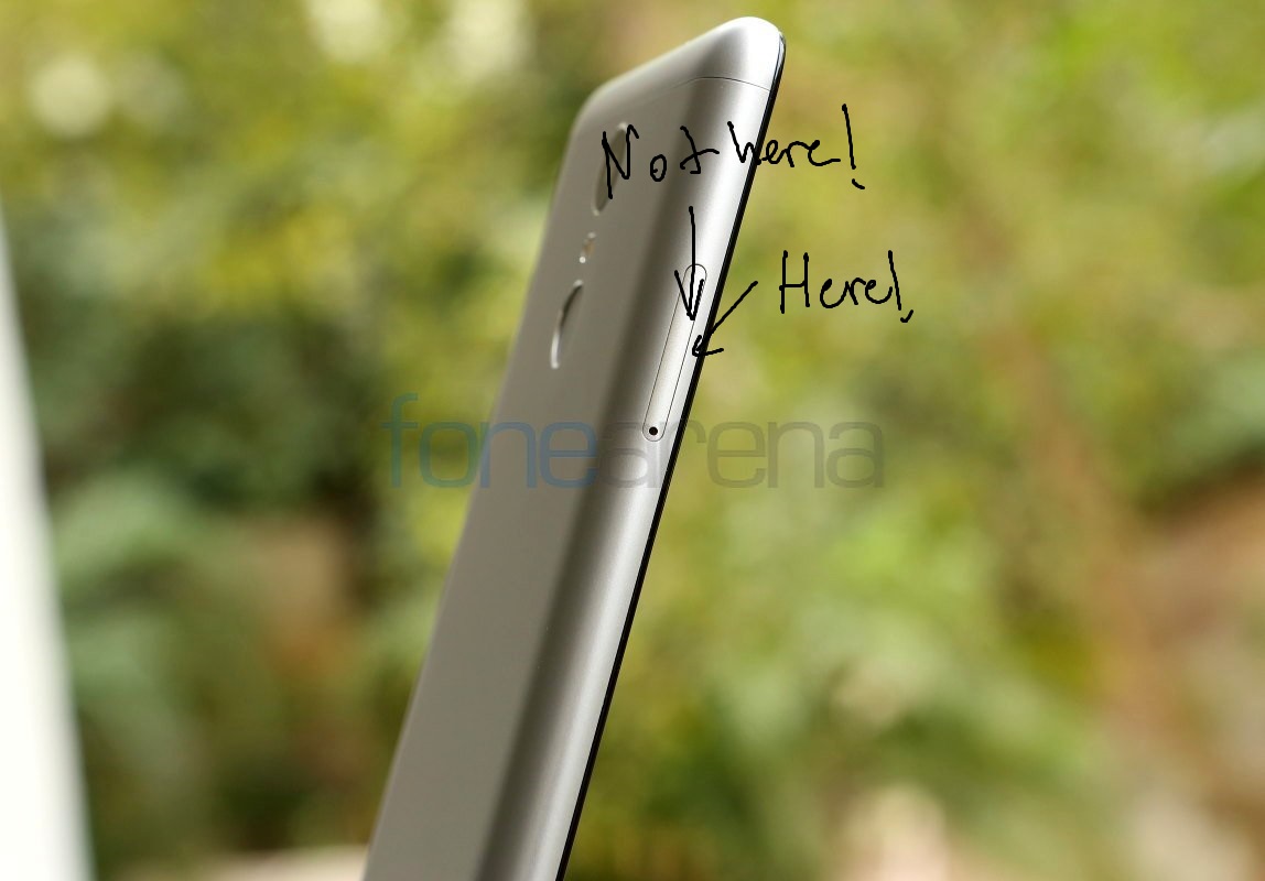

I have this phone from October 2016, this is my first problem.

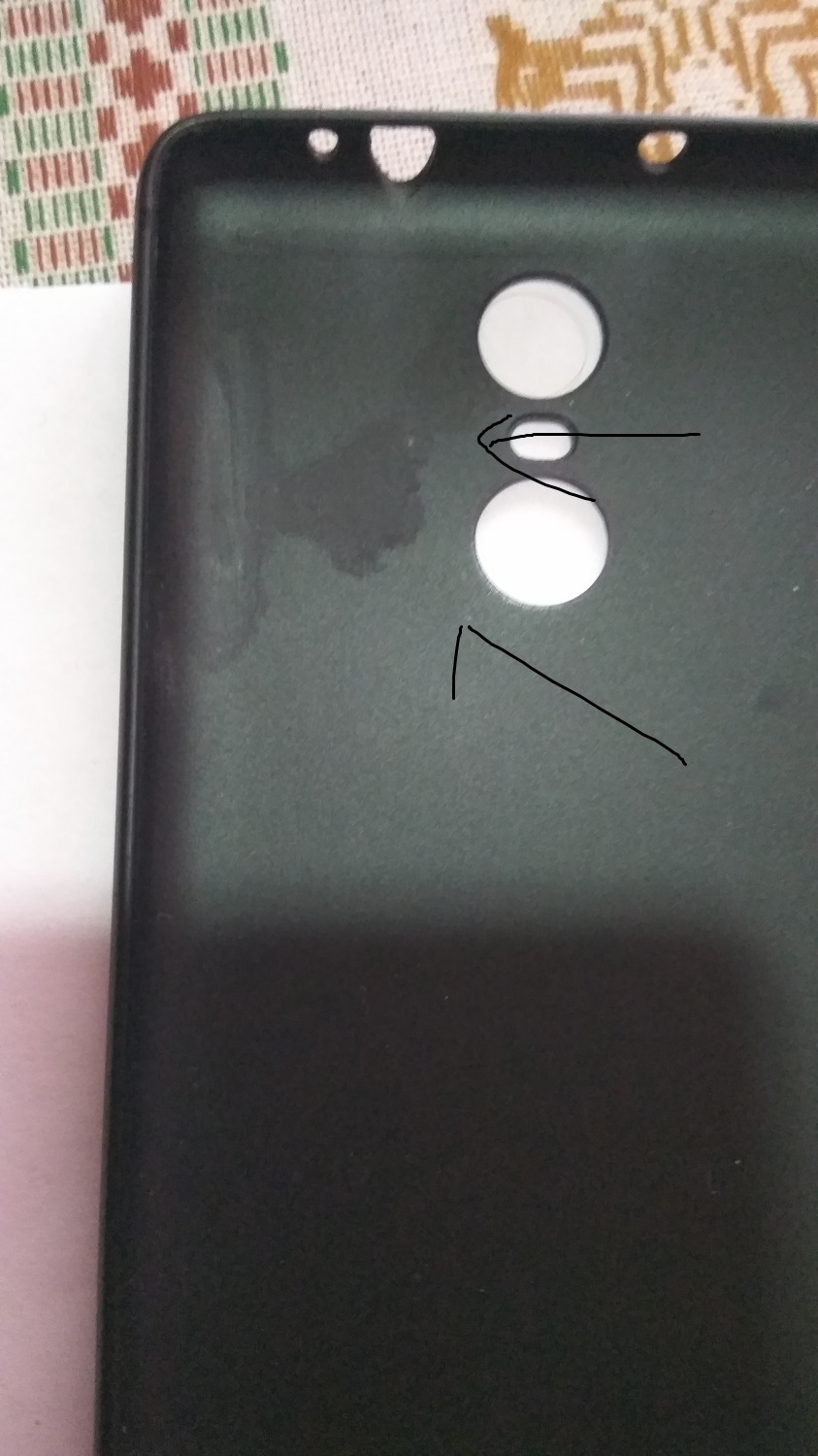

I go to open case, because he is contantly in case, and i see he is swollen. Also, i see in case in that place something, maybe this is coincidence, maybe not.
What u think, what i should do?

I would guess that the battery is failing -- this can cause it to swell up. That stain on the inside of the case might be due to leakage from the battery. This can be pretty dangerous, since the battery is at higher risk of exploding. Take it to a repair shop immediately for further diagnosis.
Thank you. But, do you think is too higher to be battery?
My battery still last very good.
It doesn't get too warm when charging or during normal usage? Another possibility is that the phone sustained some kind of vertical stress that caused that part of the frame to bow out a little. That wouldn't necessarily explain the odd discoloration on the inside of the case, though.
This is the reason why i am confused. He dont get warm, but discoloration in case is the reason why i am afraid.
One possibility is that if the phone was put under vertical stress while in the case, the case bowed out as well, thus letting in some other substance to cause the stain (like some kind of liquid). Maybe the phone was inside a bag, and you also had a leaky bottle of soda or juice?
