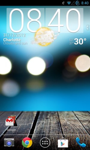

I was searching for some way to hide the bottom navigation bar and get some additional screen real estate.
I know custom ROMs can do it but I'm running stock.
Nova launcher lets you remove the dock but not the navigation bar.
On reading some threads on XDA I realized there are couple of different ways to do it.
1) Add "qemu.hw.mainkeys = 1" (without the quotes) at the end of the build.prop in /system
2) Use an app like fullscreen toggle or GMD gesture
I used option 1 since I didn't want to install an app to do this, rebooted and it works!
Now with the navigation bar gone I use button savior which gives soft keys on the side which hide as and when required.
Thought this would be useful to someone like me who thinks the nav bar is a waste of space!

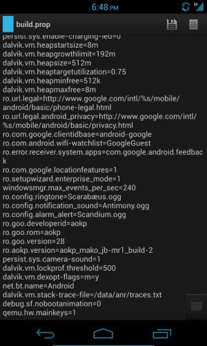

I've added that line in build.prop done a reboot but my nav bar is still there. Does GMD let you disable nav bar only? I want to keep my status bar

I was able to hide the bar after rooting my phone and I love that it's gone, now just debating on which app to use for the home and back functions.
I edited the build.prop in /system and it worked right after reboot, it was a little scary to be in there editing at first but thankfully all went well.
For my edit I made sure there was a space between = on both sides. If it's not working for you Abu that might be the issue.

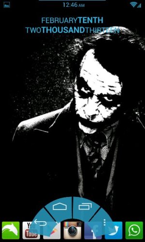

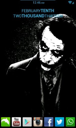

That could be the reason or that I have a custom ROM (AOKP) I think this mod is for stock ROM either way I've disabled my navbar through AOKP settings and I'm using LMT launcher (pie) for the nav buttons. Thanks for the heads up though.
