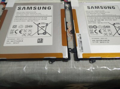

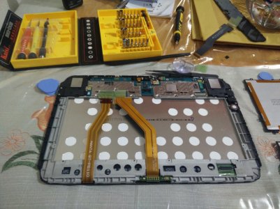

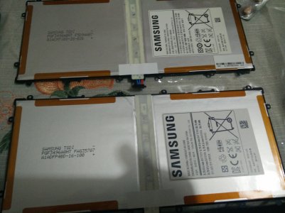

Just replaced my battery... Using my N10 to type this post... Ordered from cell phone repair shop on eBay... Working good so far... Pics attached
Cool for the pics. My replacement from same place has been in almost 2 months now, much improved to original battery. Tablet is still a strong piece!

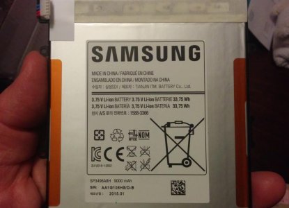

The battery was dated 1/2015 (see the photo). It cost $87.25, and came just a few days after ordering.
After a slow decline followed by 2 replacement battery failures, it's nice to find not only a Samsung branded battery but now my tablet is like a whole new device... just like brand new.
