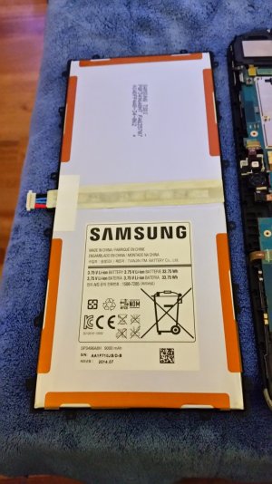

Bought a battery from cellphone-repair-shop on Monday and the battery arrived on Friday. Installed on Saturday. The battery is a oem Samsung with a manufacturer date of 7/2014. Install was easy, did not lose any data. The battery came with a charge of 85 percent so I have not put the tablet on the charger yet.

Sorry for the confusion on the Ebay store. Here is a photo of the new battery. So far the tablet is working / charging great.
Well that certainly looks a hell of a lot newer/cleaner/reasonable than the crap I was sent from China/AliExpress which totally failed.
So is this an exact match for the original nexus battery or is it a battery from another samsung tablet that happens to work?

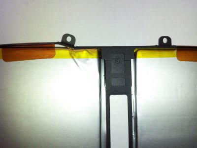

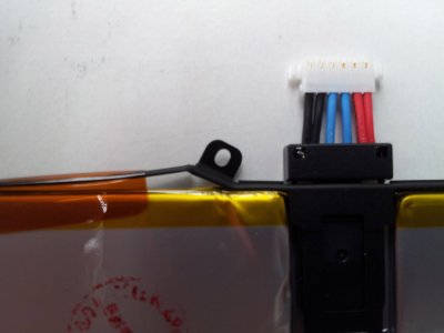

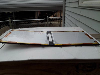

Well this sucks. Received my battery today from cellphone-repair-shop and due to the poor protection in shipping it was damaged. I emailed the seller and requested a refund or replacement. battery 1.jpgbattery 3.jpgbattery 4.jpg
