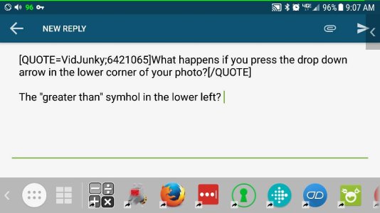

I have an a semi-transparent overlay that comes and goes, seemingly at random. It covers most of my screen. It seems to show over any apps, as well as my home screen. It doesn't show in screenshots, so my wife took a picture of it.

It looks like the silhouette or space saver for an ad. How regularly does this happen? Is it regular enough that you could turn off your data for an hour or so and see if it skips a beat? If it is some kind of broken push ad turning off data might interrupt things and prove its an ad.

So you're reporting that this is the behavior before the screen times out? I've seen devices that dim the screen just before they time out but not with a bright strip across any portion of it, it's usually just a warning that the screen is about to turn off to see if you're still using the device. But you said you could press buttons thru it, as though anything that opened would simply open under the dimness, which I wouldn't think was a screen time out warning...

Correct. If I keep the phone active, whatever I do just appears "under" the overlay. The shutdown warning is seperate. It just happens that clearing the warning also clears the overlay.
New symptom, as of today: a shaking "ghost image" of what's on the top left appears at the top right. Doesn't show in screenshots. Disapears if I wait until the screen dims, just before going to sleep, then touch the screen to keep it awake. If it comes back, I'll try to take a pic with another phone to upload.
The overlay turned solid black today and the phone was unusable. I finally realized it was cold from being outside, so I warmed it with a hand dryer. It went back to semi-transparent, but didn't go away.
I factory reset my phone, then installed every update. The overlay came back.
I'm convinced now that it's hardware, rather than software. Gonna see if there's any warrantee left.
