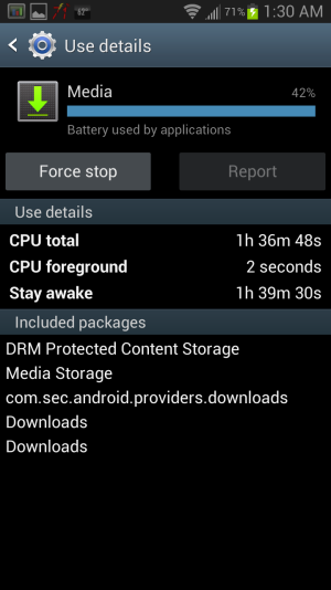

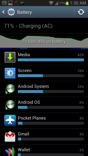

At first JB was better but i did notice when battery drain is present that under battery usage Media seems to be at the top..
So thats not good.. LOL

The people with media high on the list of things draining the battery, should consider doing a little test. Pull the sd card from the phone and run it that way for a day. See if the battery spent on media goes down. If so. You might want to start from scratch. Save all your stuff to the computer and delete the stuff from the card before reinserting it.
The scree shots show my media time and drain.
After i took these shots i went into the applications section and found the com.sec.andoid.providers.downlads and force closed then did a clear data.. So far seems to have helped.
