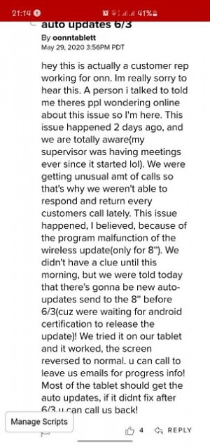

Did this happen after a system update, or does it seem unrelated? Considering that it seems to be happening to a number of ONN tablet owners, I'd suspect either a glitchy update, or faulty hardware or firmware.
As I look through a number of recent posts asking about this same issue, it does appear that it happened after a system update. My guess is that ONN messed up its update. Your best bet at this point is to contact the manufacturer for support (and hope they actually have an IT support team). Or, since ONN appears to be exclusive to Walmart, contact Walmart's customer support.
Re: Why my android is showing reverse display?
I found this information online and it may help. There is an update due 3rd June.
