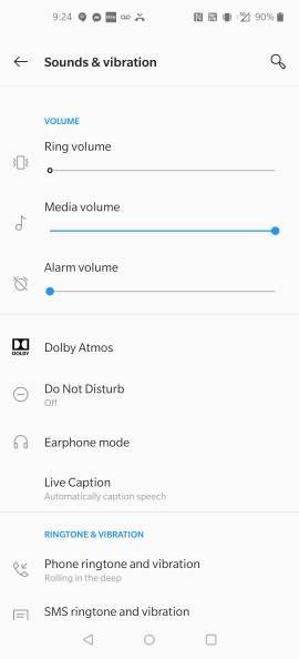

Also, can you open the quick settings panel, take a screenshot and post it here?
Re: Ringer problem on OnePlus 8 Pro.
As you can see in the picture, the ringer volume slider has the open black circle which cannot be moved. The other volume sliders have the movable blue dots.
That's what happens when the physical slider is in the Vibrate position. Try to move it and see if anything changes. Also, the slider can accumulate a lot of dirt, clean in with a toothpick just in case.

Thank you Javier P and msm0511. It was the physical slider. I must have accidentally moved it while removing and putting on the case. I didn't even know what that slider did. Now I got my phone ringer back!
