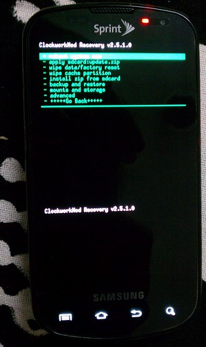

1) Download the ROM you would like to install, leave it in it's ".zip" format, and place it on your phone's SD card. Turn off your phone. Now hold volume down + camera button + power button simultaneously until you see this screen (ClockworkMod Recovery):
Credit for picture goes to Ahmgsk
(Note: if instead of this screen you get a similar screen but with blue text, go to the apply update.zip option at the top and select it. This should take you into the screen you see above.)
(To navigate in Clockwork, use the volume up and volume down keys. To select options, use the camera button.)
