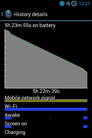

The rom is running great no fc or reboot issues so far and clock lag doesn't seem to be an issue either. Acording to this screen shot its even sleeping correctly however the battery life is not so great.

http://img.tapatalk.com/d/12/12/31/y5a8urut.jpg
Sent from my LG-VM670 using Tapatalk 2
You can try these build prop tweaks from the CAI build.prop and the 99youtube fix from the init.d folder. And if you use bluetooth, idk if it works or not yet, but there's a bluesleep fix on permissions in the cai thread somewhere. And for the launcher issue, try to fix permissions in recovery, command line, or in Settings. Or move the launcher to internal memory or remove hololauncher completely
