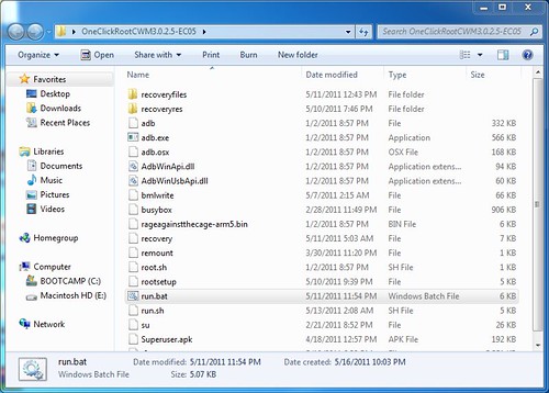

2. Go to this thread and download OneClickRootCWM3.0.2.5-EC05.zip (filename is correct, this zip works for DI18, EB13 and EC05) onto your computer, then extract it to a folder on your desktop.
[NOTE]The file you downloaded above may be recognized by your antivirus program as "rageagainstthecage." This file will not harm your computer. The reason it is detected is because it is a security exploit - one that allows the changing of secure Android system files (which is the entire point of rooting!). So no need to fear, it is completely safe. If your antivirus program deletes, quarantines, etc. this file you will need to either mark it as safe or disable your antivirus software altogether.[/NOTE]
3. On your phone, push MENU, then select Applications > Development, then enable USB debugging and connect your phone to your computer via USB.
4a. If you are using Windows, go to Step 4b. If you're using OSX or Linux, go to Step 4c.
4b. Download and install the appropriate drivers for your Windows system:
32-bit drivers
64-bit drivers
Plug your Epic into your computer via USB and let Windows recognize your phone/configure the drivers. After Windows is done with the drivers, unplug your Epic.
Now double click "run.bat" in the folder from Step 2. Once done, proceed to Step 5.

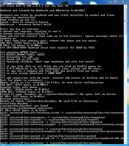

5. Follow the on-screen instructions to complete the process.
[WARN]The type of USB cord and the specific USB computer port can make or break the success of this installation. If you are getting errors in the command prompt during this step, trying swapping USB cables and/or switching USB ports (even the USB cord that came with the phone can cause problems!).
If the command prompt says "device not connected" after using multiple USB cables and/or ports, try restarting your phone and computer and rerun the rooting script.
Antivirus programs can also cause problems. If you still can't get the run.bat file to work, try disabling your antivirus software.[/WARN]

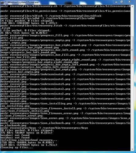

If all goes well your command prompt should look something like this (picture is from Windows but will be similar to OSX/Linux):
