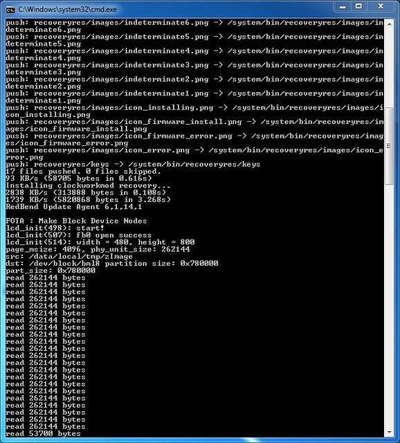

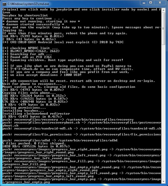

4. Now double click "run.bat" in the folder from Step 2. If all goes well, your Windows command prompt should look something like this:
If the command prompt asks you to restart adb, you need to go into Windows Task Manager (ctrl-alt-del on your keyboard) and end adb in the process tab, then go into the folder from Step 2 and double-click on the "adb" file to restart adb.
If the command prompt says "device not connected", disconnect the phone and reboot it, turn debugging mode back on, reconnect the phone via USB, and rerun the "run.bat" file again. If you're still getting "device not connected", try repeating these steps one at a time or in a different order, for example just kill adb and rerun "run.bat" or only reboot the phone and then rerun "run.bat".

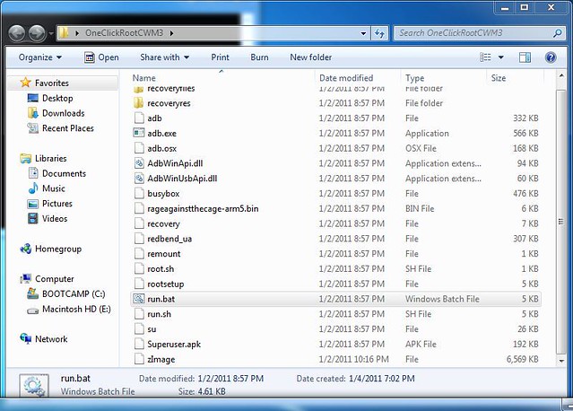

3. Go to this thread and download "OneClickRootCWM3-EB13.zip" (filename is correct, this zip works for EB13 and EC05) onto your computer, then extract it to a folder on your Windows desktop.
4. On your phone, push MENU, then select Applications > Development, then enable USB debugging and connect your phone to your computer via USB.
5. Now double click "run.bat" in the folder from Step 2.

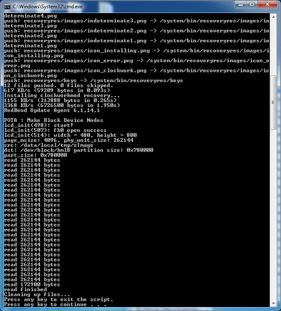

If all goes well your command prompt should look something like this:
