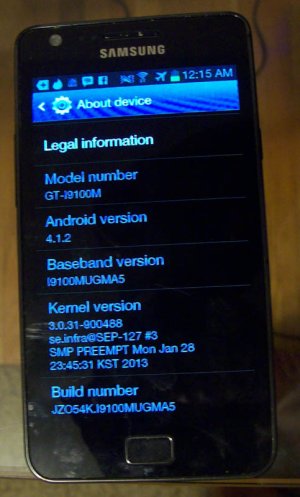

I have the s2 and I want to root it.
Model Number : GT-i9100M
Android Version : 4.1.2
Baseband version : i9100MUGMA5
Kernel Version : 3.0.31-900488
se.infra (AT) ep-127 #3
Build Number : JZ054K.19100MUGMA5
Here is the background : I have purchased a Gear Fit to use with this device, but I need 4.3 on the phone.
I have tried to upgrade the device to no avail using the One-Click method. It tells me that it is not compatible. I have been researching and it seems I need to root the device first and then upgrade the firmware manually.
If any of this sounds wrong, please let me know. I don't want to brick the phone, but would like to upgrade the device. Any help would be greatly appreciated!

Here are my specs and I don't see anything like that :
So I am trying to follow rootings steps and can't get past the first part! If I can't find the root kernel that matches or even close, I cannot begin the process. Very frustrating.

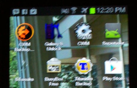

Ok working on it now, first pass successful. Now the stock kernel.
Went and re-rooted it again using another guide "rooting for dummies" with a different kernel and now it booted. Ok, what next? I am guessing flash a recovery? flash a build of CM along with the right build of gapps.? I want to put on 4.3, so will this all lead to that?
Backup, went to Root Checker and it says the device does not have a proper root! I used the
Siyah kernel.

Cwm can be flashed in Odin. As I recall, you can get the file from clockwork mods website.
Here is the method:
How to Root the Samsung Galaxy S2 (Canadian) | TheUnlockr
I had to use Siyah kernel and not the one listed because - when I used the one listed in the link, the phone hung at the start up screen. I tried flashing again using the Siyah kernel and this time it booted (yellow triangle and all).
There are two screen shots of the phone now.
