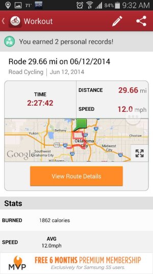

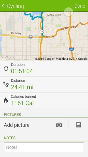

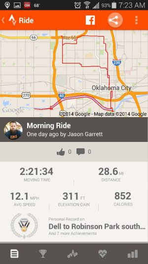

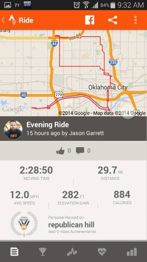

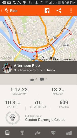

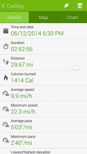

So recently I noticed that when I use S Health for cycling it seems like it's inflating my distances. So today I decided to run S Health and Strava simultaneously. I use my Gear 2 for both within starts each app. The difference was pretty staggering. It wasn't like this on my last S5? I had to swap it out due to the bluetooth not working properly. I'm guessing it's not the GPS because Strava uses the same GPS and works fine. Any ideas?

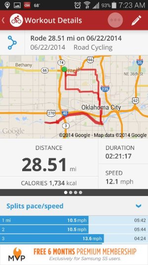

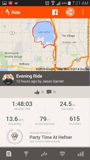

Looks like it isn't 'pausing' like maybe I figured out how to turn on with Strava that my Map My Ride has always done - so, my time and average speed are down. I need all the help I can get to make my average speed look more respectable. Distance was spot on though.

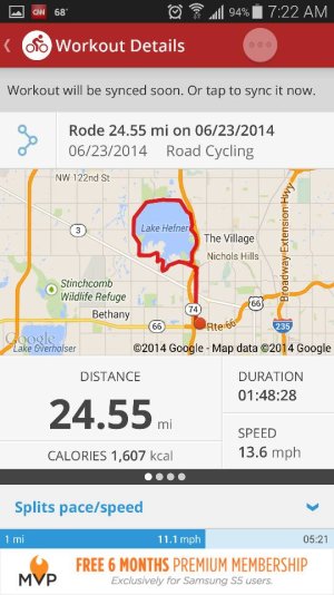

Mine are accurate
