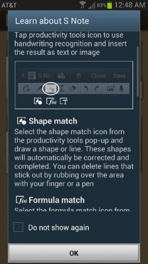

A screen shot of the missing icon would helpful. Is this the icon you're missing? If you have it just click on it to get the other productivity options.

It is missing on mine too, and the only reason I know is because that little tutorial you posted keeps popping up.
Sent from my SAMSUNG-SGH-I317 using Android Central Forums
Folks are still missing the question. There are some templates in S Note that DO NOT OFFER THE PRODUCTIVITY TOOLS ICON.
For example, the Memo template does NOT have the productivity tools icon. However, the other templates all seem to have the icon.
My question is why do some templates have the icon and some don't?
Lurch is right. Is there a reason that the Memo template does not have the prosuctivity tools ? Seems to me I would like to have it here as well as the other templates
