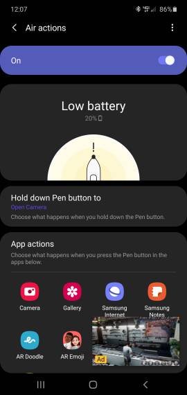

Looks like I have a malfunctioning battery. This is the first time I've been able to get it to connect.
I watched the video. Nothing new. I think you should also toggle off "use multiple S Pens"and clear the cache of your Air Actions app. If that doesn't solve the problem clear data and force stop it. Then open it again. Then reset the S Pen again. Do you have a case with a magnet or any other accessory or device that can cause magnetic interference?
