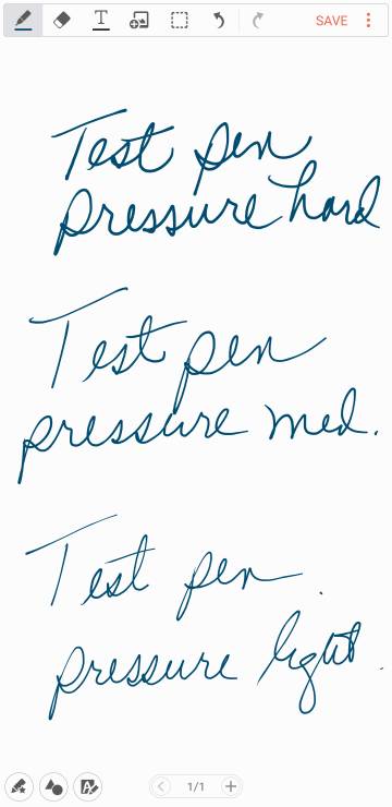

But any chance could you be varying the pressure on the pen as you write? Below is a sample of varying pressure in S Note, without changing the pen setting.

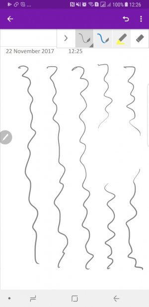

So I have now found out that there is a part of the screen near the edge panel where my spen wont write at all. I switch off the edge panel as well but no joy...took off the careen protector thinking that might be the issue but still no joy...factory reset my phone but still no joy...any ideas guys...Have attached the pic.Screenshot_20171122-122651.jpg
Damn it...found the reason....I had a leather cover which has a magnet near that area.....took the cover off and lo behold all ok....I loved that cover....what a shame!!!!
