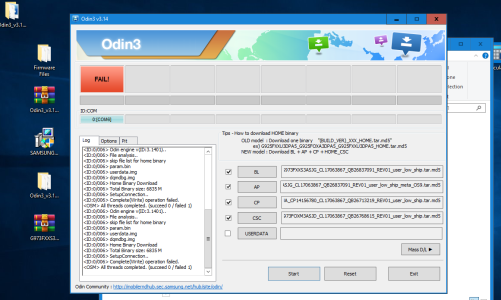

okay, so the wiping of the cache partition didn't work. (of course) however, there was an option for ''lacking in storage booting''. I'll try that option first. When I went into recover, it told me to go there. It says it will be temporary and that I need to back up ASAP and then factory reset. I'll try the lacking in storage booting first and see if I can back up. If all else fails, I will try reflashing the firmware. Going to have to wait for another hour for the battery to drain now.
Ok keep me updated.
The device is in download mode correct?
Yes, it is in download mode. Also, the cable is not the official cable that came with the phone, although it wa still able to connect. It stuffed up the first time because the cable i used was fishy. I think might need to power it off and go into download mode again to reset it and see if it works.
and also all the firmware files should be correct. It's the same one as the current firmware in my phone. I haven't updated it since. I am also using the newer odin version
Yes reboot into download mode , dont be discouraged try different port and run again
hey. I've decided to actually go to a amsung store before I do the flash.Because what if the reflashing fails and I take it to the Samsung technicians? SO yeah. If the samsung technicians or phone repairers can't fix it, I'm going to reflash it.
