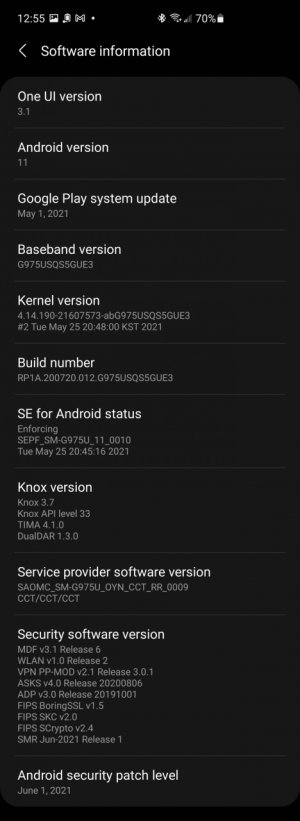

The only software change to the phone just before this was a security patch that I downloaded a few days prior. But I haven't been able to find any others having problems with it. I did have some moisture detected in the USB port a few days before this problem started happening as well - but the phone was never submerged in water and the message cleared within an hour.
