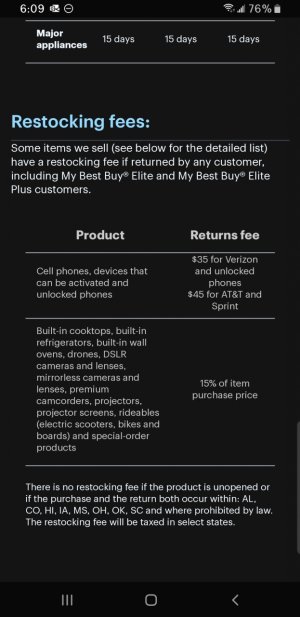

Apparently, Best Buy charges a restock fee even for an exchange, which I find odd, but yeah. What's weird is, once I opened the packaging, I did notice that the seal on the phone box itself was broken. My device has an April 1, 2019 build date. I thought it would be "newer" than that.
Is that something they do for unlocked phones? I've never bought a unlocked phone, I just know for carrier phone you can exchange under warranty with no restock fee. You only get charged a restock fee if you return the phone.
All open box phones. Carrier & unlocked, except for the states listed at the bottom of the screenshot.
But if the item is proven to be defective, there should not be a restocking fee.
I was assuming the OP was trying to exchange under warranty, defective issue since they were detailing issues with the phone.
