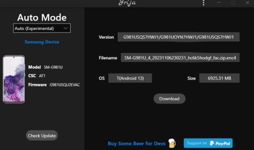

So with Frija (fully updated) and SM-G981U (S20 5G 128GB) selected as my model, I can download this CSC:
-TMB
These CSC say - error: CSC not found
-XAA
-VZW
This CSC says - error:CSC not supported
-ATT (even though my phone is branded ATT and has ATT apps loaded?)
So my only choice from your list is TMB - that being T-Mobil.
So is there another place for Samsung unbranded software downloads besides Frija and if so where? Or is that just for VZW & ATT firmware?

Ok no problem
SM-G981U this is your current model
Samsung makes 2 versions of it
The carrier is your model number SM-G981U
The other is Samsung unlock bloat free
Model number SM-G981U1
You can flash to model number if you choose
SM-G981U1
For model number SM-G981U on frija is TMB CSC
If you decide to go on unlock model number SM-G981U1
CSC available is TMB/VZW/XAA
Since your model number SM-G981U which is a carrier version and Att if you use TMB CSC it will work without issues but sometimes carrier can have different bootloader and will prevent further updates by over the air from manufacturer until your on the same as your original phone carrier Att.
Me personally would flash to unlock model number SM-G981U1 with CSC XAA
Which unlock bloat free and is updated by Samsung not carrier like your version
Hope this is more clear

Awesome thanks for the clarity!
I was not fully understanding that SM-G981U1 was the unlocked I should be using in Frija vs mine : SM-G981U.
I agree completely I want to be using CSC XAA and I see that available now to me.
Ok i'm downloading CSC XAA to my computer (Window 10 64bit) now, thanks.

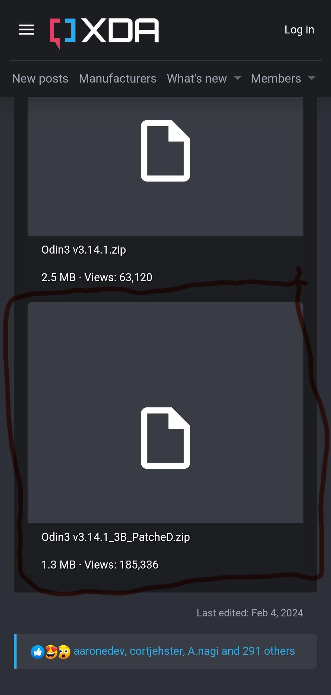

New here ;) So can I install SM-G981U1 XAA csc in my s20 ATT version SM-G981U with non patched odin that is version 3.13.1 or i need some different version of odin???
Hi welcome to AC!
You can flash to the unlock firmware but you will need Odin Prince Comsey otherwise known as Odin patch B
Download the last Odin I circled
Frija tool
