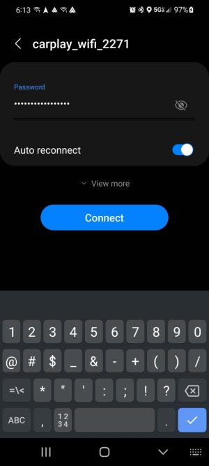

S21 attempt to connect wifi, network "carplay_wifi_2271" but it is asking for a password?
  • Start date Start date
A
Android Central Question
I bought a used 2013 Porsche Cayenne Turbo and discovered it has AA. When I connect via USB, everything works as it should. I would prefer to connect via wifi. I have been able to connect the Blutooth and the phone shows up. Does anyone know what the password might be or how I may reset the password? I am guessing this was an add on to the factory head unit as there is a usb plug in the passengers foot area that sticks out from underneath the center counsel.

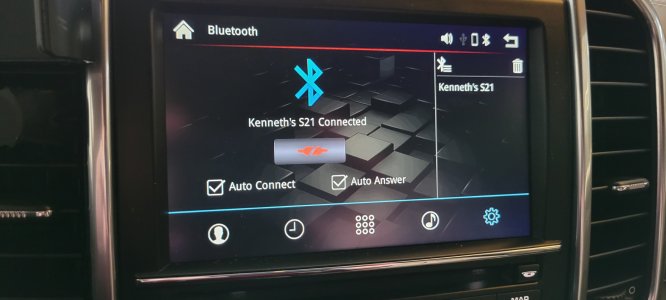

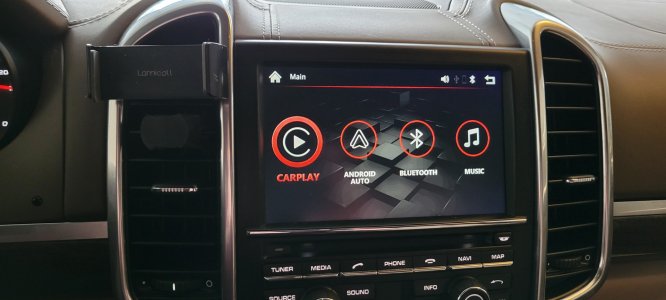

Thank you for the replies. Now a member. The head unit is stock. There is no manual for the AA nor can I see where the usb cable runs to. The way I can access AA on the head unit is by pressing the nav button twice. I found it by accident. The car is from Georgia, I live in IL. Maybe I can trace it back on Carfax. There were two previous owners.
Are there any passwords that I can try that may be universal to the unit? It is looking for a minimum of 8 characters for the password.

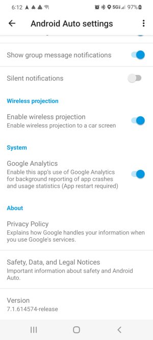

Here is what I see on the phone. The AA menu has an option to view the settings menu on the phone. This is what I see. I thought there would be a password menu or something available since I was hardwired to the unit but there is nothing in the menu that I can see.

When pressing the gear, the image shows what is displayed. Nothing else.
You mean the image that says "Kenneth's S21 Connected"?

Keep in mind that wireless Android Auto is not universally available -- it's only on certain systems, and since yours is probably on the older side, I don't think it'll be possible. https://www.lifewire.com/android-auto-wireless-4176354

The Android Auto functionality you have is NOT stock; it's a retro-fit module fitted inside the PCM head unit which allows the display to switch between native functions and Android Auto / Apple CarPlay - I fitted one myself to my Panamera. You will have a separate unit, about 9x4x1 inches, possibly fitted above the passenger footwell panel / below the glove box. There should be a trailing USB connection - maybe in the glove box, dangling below or possibly even routed to the centre storage bin between the seats.
