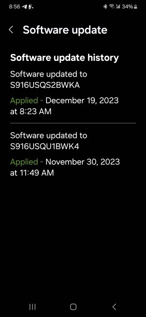

YES!! It is frustrating to have to keep the phone near for phone calls. The trouble I have now seems to be only incoming. I say hello and hear them, but after we exchange any other sentence, they no longer hear me and I have to activate the speaker.
The incoming trouble started after the update on Dec 19. The Bluetooth sound drop-off in videos with the Nov 30 update.
I have not looked to see if i could restore to before these updates... I want my phone to be up to date. I just need developers to look for the trouble.
