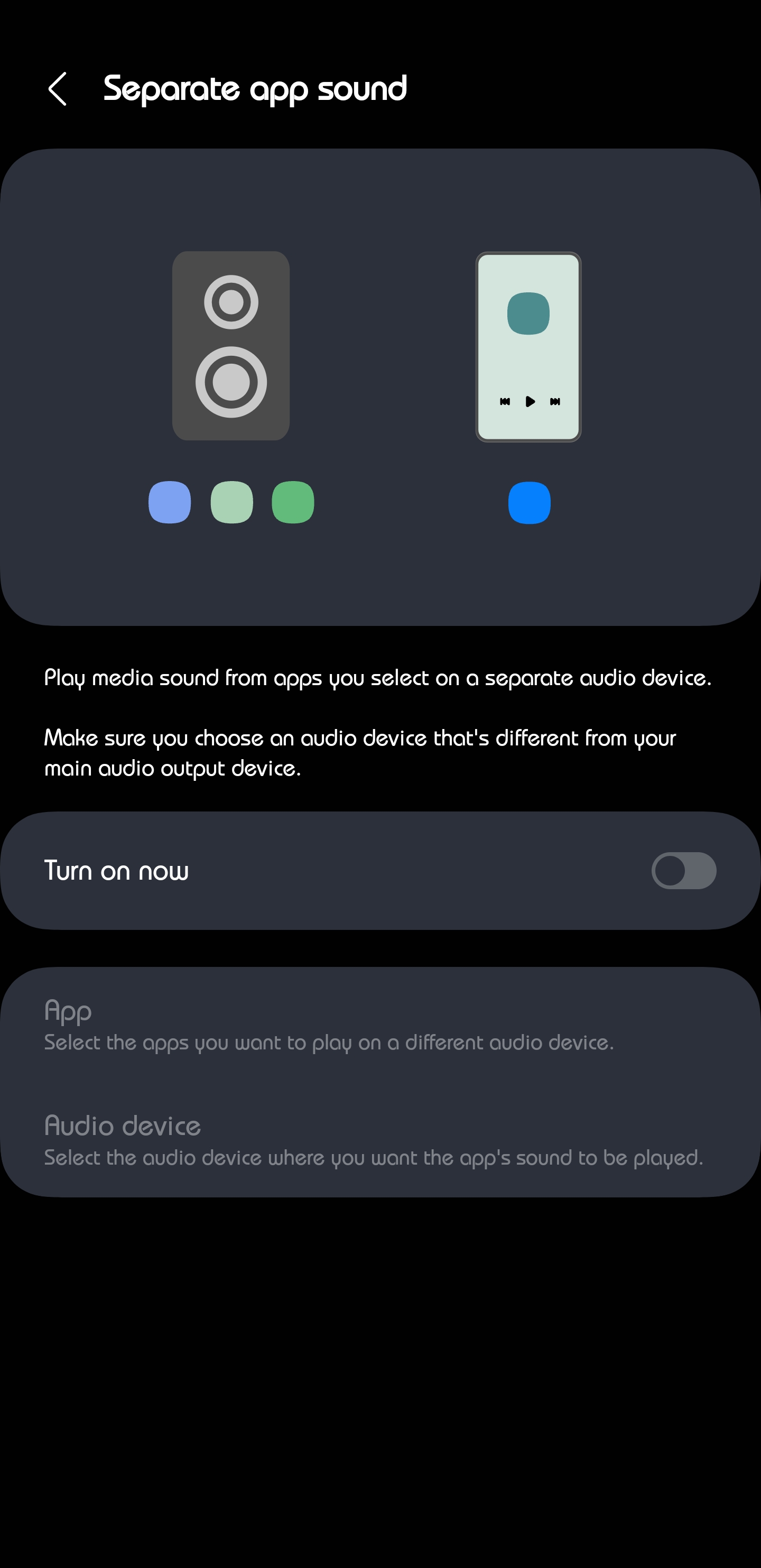

Are you using separate app sound?

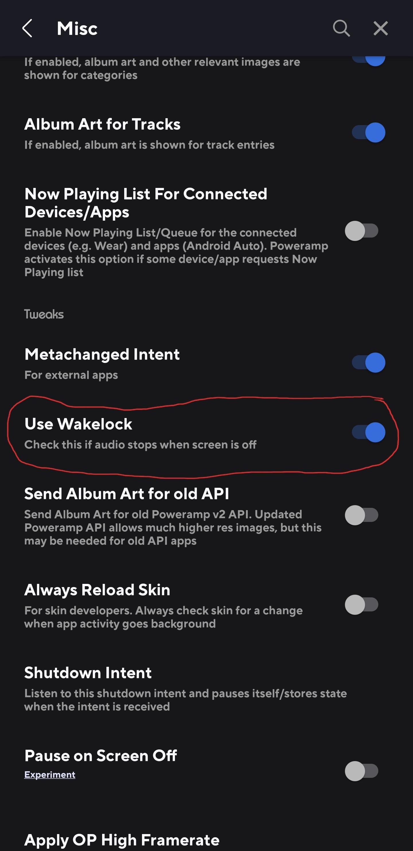

For Poweramp, check if this is enabled.
Can't find either Misc or Wakelock on my phone.
