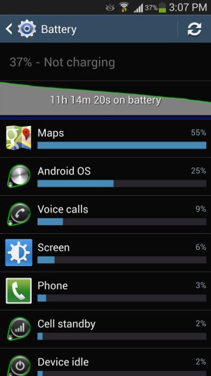

Here's a pic of my battery life, which shows google maps draining it for no reason :S
thanks

Would you by any chance be able to show us your Maps settings and location access settings?

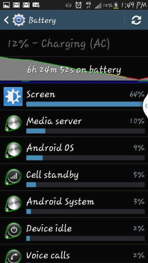

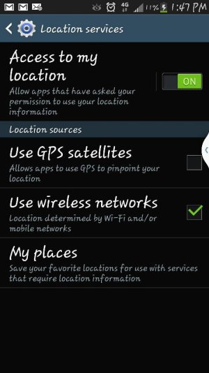

STARGATE
Ambassador
Oct 8, 2012
6,586
36
Visit site
Go to Settings > More > Location services and turn off "Access to my location"
This will help you out and you shouldn't see Google Maps in your Battery usage
Still, maps shouldn't drain that much with that setting turned on.
I have it on all the time and it doesn't drain my battery as much as her phone does.
Sent From a Galaxy S4 Away!

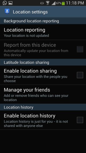

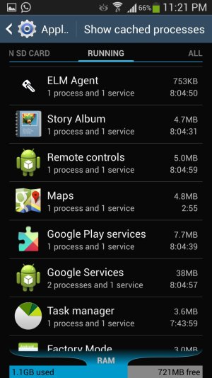

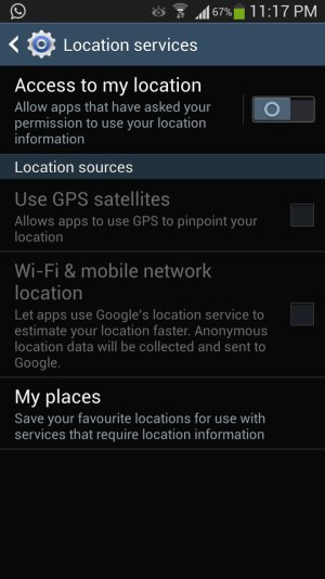

Thank you all for trying to help. I have all location settings switched off as shown in the pics below. However, maps is still running on my application manager and on my battery status. It is still the highest percentage on the battery status, now giving me 42% and my screen 12%.
It's really frustrating, as Im also only using the phone on wifi now ( bought it 2 days ago), still haven't got a data plan and the battery is acting up. Please help :)
Yeah that's a lot for it to not be used. Maps takes up none of battery when I'm not using. In your sync settings, what google services do you have set to sync? Try force closing, clearing cache and rebooting phone. Install wakelock detector to identify exact processes that are running.
