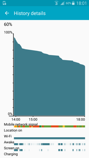

Hello! My S4 is draining 1% every 2 minutes no matter what. I tried everything, 3 different batteries, gone back to Kitkat 4.4.2, CM13 with a lots of battery apps and custom kernel, battery saving mode, limited 2 cores of the proccesor...but nothing! Still drains 1% every 2 minutes no matter what! I had a s4 mini before, and I don't remeber it draining so much battery

In your original post, your cell signal was pretty poor. If you're in the same location now with the same poor signal, that can be a large contributor.
That's also a 6 year old phone. I think the biggest issue is simply the batteries are old and worn out. The bad news there is they are no longer produced and any "new" battery will be old stock and also most likely degraded from sitting on a warehouse shelf for years.
Combine that with simply being out of date in every other aspect, I think it's time to upgrade to a new(er) phone.
