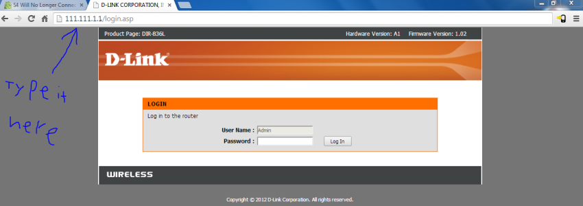

You do know you can go to your computer type in ip address of the router and you can set your own password to your wireless router rite? For windows computer (it has to be connected through a cat 5 wire) go to your start bar type in cmd pull up the command prompt type in ip config then you can simply type in the ip into your browser and bingo you can access the firmware on the router :) set up a password for administrative use then set up your router password

Um yes I am serious cmd opens your windows command line ip config = ip configuration.. it will pull up your ip# type your ip # into your Internet browser search bar it should pull up the screen for the administrative user name and password password if your reading it off of a sticker it's default network user/password so type those in and edit and change your stuff its really simple

Capture.PNGstart bar go to the section where you type it in cmd click it type in ipconfig

you take the ip default gateway address type it into your internet browser and boom
