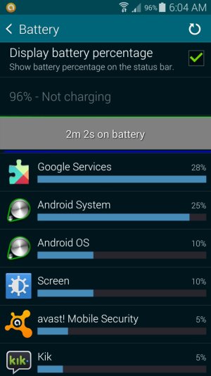

Edit 1: Seems that Avast Anti Virus is at 38% which is around its norm but Google play services is at 34% and I cannot force stop which seems.. Odd..
Screen Time says it is 9s.

In regards to the anti virus. This morning after I left the phone on charge all night the anti virus was only using 5% so I think it was running a scan when I screen capped. Google Play is still high up the list however.

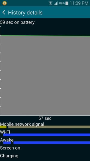

As a last attempt I would reset the phone to factory and see how it goes. I know it's annoying to have to reinstall everything but if it fixes the issue it may be worth it.
As per your screen shot, the phone is awake constantly. I would go in the task manager and see what's keeping it awake. Then delete that pos app

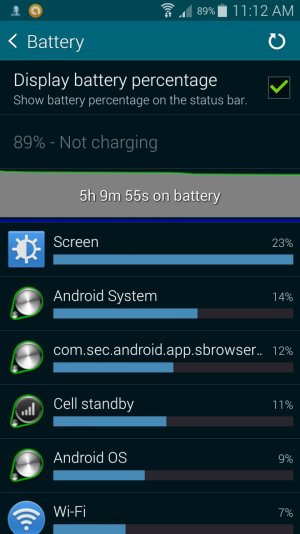

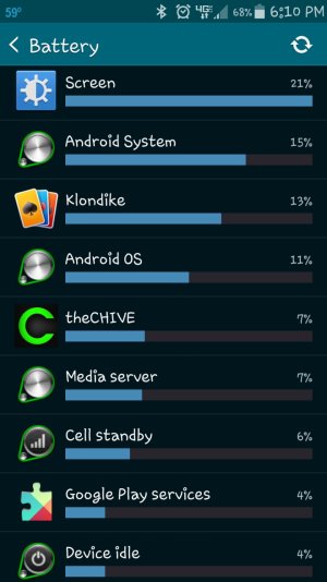

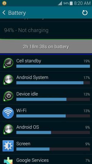

I do not know what is happening however I will send two more screen caps as the battery life time seems to be increasing over the period of the day so far. However I did delete all my games and a couple of useful apps I use last night so perhaps I had a corrupted app and it's taking its damn time recovering.
Here's screen caps from earlier in the day.
Avast has dropped right off the list now. It's odd however the phone might just be having a lull before it decides to go full melt down again. As it has stopped overheating before then started up again. I am going to stare at it like mad from now on though. :)

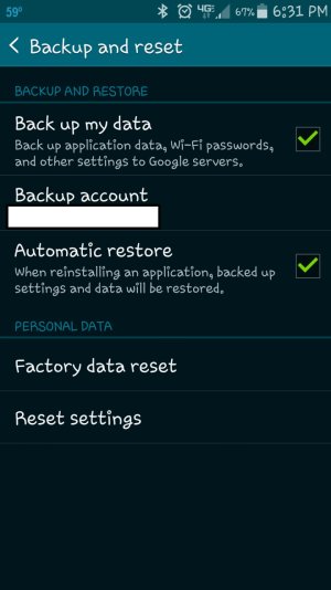

Also I just noticed this the other day, Under backup & restore in settings
Reset Settings. First time I noticed it. I Actually tried it the other day to clear up a Bluetooth issue . It doesn't wipe the phone but I think it does more than clear the cache .
