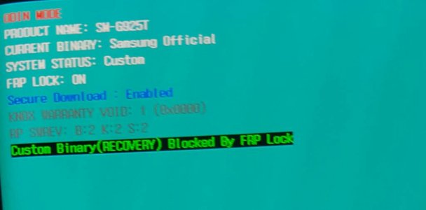

Hi
I got s6 G920t I Was flashing stock rom now it's on bootloop to get it out from bootloop when I try to flash kernel with odin I get this message as in the picture how solve this issue ? Can't flash recovery can't root get this msg while rooting and flashing kernel
Ok so i can think of a few things to try. First off did u remeber cheak debuging mode on the phone and oem unlock first? If not then u need to restore samson kies. If your s6 is going strait into download mode with out propting u to enter downloas mode first hold down both voulumw up and down with power till it turns of charge to 100 percebt and manually enter download mode with voulume down home and power at the same time and flash stock firmware with odin. Make sure its the same build date as the firmware your flashing. Also MAKE SUEE ANTIVIRUS AND WINDOW DEFENDer IS OFF COMPLETELY and FIRE WALL must b off TOO
