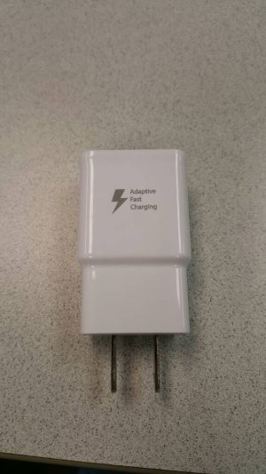

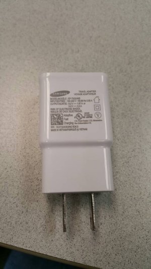

I would maybe take it back and ask for an official charger. This is the one I got. Once I plug in it scrolls charger connected then fast charger connected right after.

Its wrong charger, EP-TA10UWE is for Galaxy S5 and doesnt have adaptive fast charging.
EP-TA20UWE is the one that comes with S6/S6 Edge and support adaptive fast charging..
I can vouch for this cos I have a non fast charger plug and fast charger plug because I needed a spare plug. It does make a big difference in charging, the fast charger is much quicker
