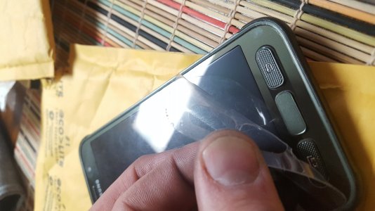

I managed to peel my one off too using a square razor blade to pry it up in the corner. It took a few attempts to get it right.

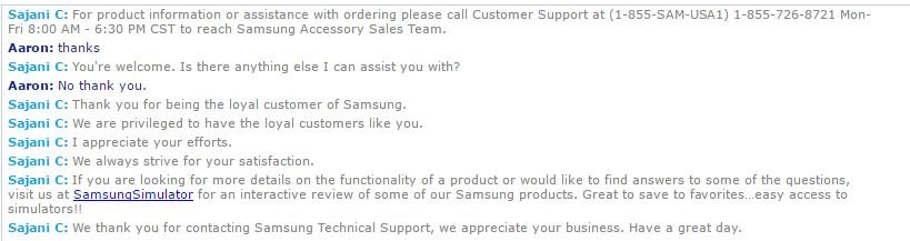

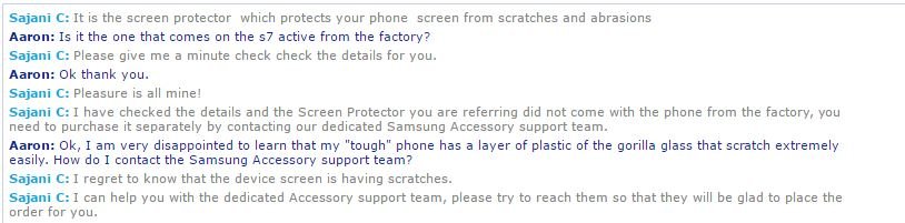

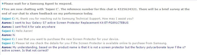

I thought my chat with a samsung representative regarding this part, Galaxy S7 active Screen Protector Replacement Kit (ET-FG891CTEBUS) may be of interest. The representative claims that this is NOT a replacement for the polycarbonate layer that come on the phone from the factory.

After calling Samsung I was told that the ET-FG891CTEBUS would be the replacement but when I talked to 3 different people in the sales department about it all they would say is that they are out of stock. Then they proceed to hang up on me lol.
I also spent an hour on the phone with an ATT android support rep, Her manager and her department Samsung rep did not now about this. I had to send them pic of me with a gift card lifting the top left corner up to prove that it was not the clear trash that all phones come in. Also funny thing Scratches on the poly screen protector might void your warranty according to ATT.

Hi, i Live in Mexico and have buyed a s7 Active for a real bargain because the screen was so scratch that appears like the past owner try to clean up with sandpapper. and i though that in my next trip to USA, i will change the screen, all because the phone is in perfect condition but not the screen. So, i found this topic in this forum and think that i have nothing to lose. So i took my little victorinox knife and peel the polycarbonate screen in the gap between the round end and screen and remove it completely and.... Surprise, the gorilla glass 4 under the top layer was totally impolute. After that, i put a tempered glass to the gorilla glass 4 of the Active waiting for amazon to have the replacement part to install and install a new tempered above it.
Excuse my bad english and i hope you can understand it. But YES it can be removed totally safe. Cheers

Read this post and figured I didn't have much too lose. I looked closely at the screen and didn't think there was a factory installed screen protector on it. Took my exacto knife to one corner. Took about 5 tries and found the right spot and sure enough the factory polycarbonate screen protector came off easily.
Now all those bite marks are gone and there's a pristine screen I have now. Wondering if I should order the factory replacement or go with a third party screen protector. Don't like the idea of a screen protector on top of another screen protector.

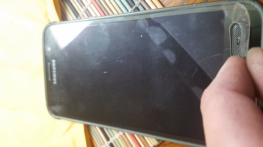

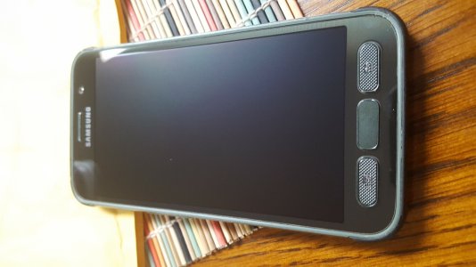

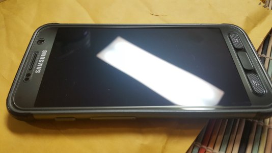

So, I bought a used S7 Active off of Swappa (for crazy cheap) after hearing about this trick on here. Thank you guys so much for sharing this info! Here is some shots of me removing the film layer on my newsed S7 Active, and shots after placing a tempered glass screen protector. The procedure had me a little worried because it took about 20 gouges with a razor blade to the corner before finally catching it just right to get enough leverage to start pulling. The layer I removed was scratched like crazy, and there was even a decent-sized gouge in it. The Gorilla Glass 4 underneath remained 100% PERFECT though! So happy I took the risk. Thanks to all who contributed here. Here's some pics.
