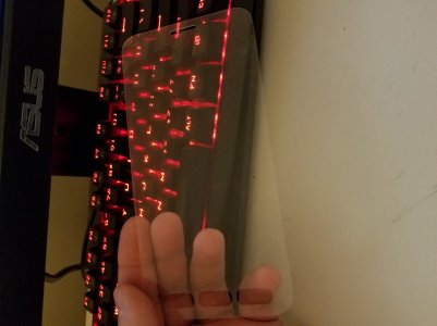

After having this phone since July I accidentally put a huge scratch in the poly carb layer. I have been trying to find video or photographic evidence of it being removed and since I could not I decided to have a go anyway. The image above is the layer that came with the phone removed. It is pretty thick. I plan on getting a glass protector as soon as I can but it is nice to actually have a screen which doesn't mark easily and attract finger prints.

Even a bit opaque as well... I mean not totally crystal clear. That's interesting... thanks for the info and picture "tj"! Hey, try "Bodyguard HD Contour" Tempered Glass screen protectors - they go on pretty easy, are fairly thick and I don't find (much) of a problem with fingerprints! (I originally said Zagg then realized my AT&T Rep had a problem with the Zagg and ended up using the Bodyguard!)
The screen was fairly dirty and I dropped the adhesive side on the carpet so it is clearer than it shows above. I just wanted to provide photographic evidence that it actually comes off for those nervous about doing so.

Confirmed. I pulled mine off starting at the top corner. I just used a sharp pocket knife (w/lockblade!). Took all of 45 seconds start to finish. Dont dig deep, it is pretty thin.
Not sure why I would put an additional screen protector on Gorilla Glass 4. My last Active 5 screen looked new after 3 years. I dont think an additional layer is going to add much protection, the polycarb was just there to keep all the glass shards in place in the event of breakage I am guessing. same way it works on a windshield; only on a car it is poly carb sandwiched between 2 layers of glass (which would have been the smart way for Samsung to approach this problem).
My S7 Active fell between the seat and center console of my Explorer, and extracting it put a nice inch long scratch in the top layer. I had seen this post some time ago and decided to confirm for myself the top layer was removable. It is, and the glass underneath was pristine. I used an exacto knife on the corner to get it lifted, and from there it came off like any screen protector would. I stuck the phone in a sock and put it away in a drawer until tempered glass screen protectors arrive, lest I scratch that pristine glass.
