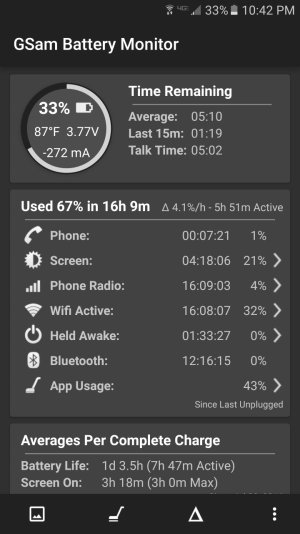

Wow, 0.5%/hour? Do you turn everything off or something? According to GSam, my S7 consumes about 2.5%/hour while idling in my pocket or on my desk, but I don't turn anything off. Wi-Fi, Bluetooth, NFC, Location, everything is on.
Actually using the phone though, it ranges from 5%/hour to 20%/hour, which is pretty high, but I came from using a Lumia 640, and surprisingly, both the idle and usage consumption rates of my S7 match the battery consumption rates of my old Lumia 640.

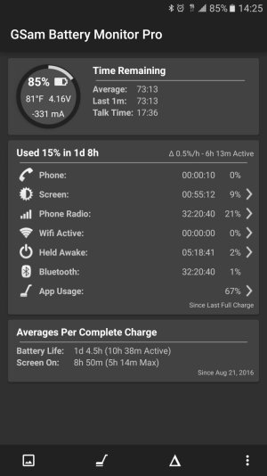

You have to take into account the higher pixel resolution and the more powerful hardware. Also depends on how you've set it up. My setup idles at 0.5% per hour but on particularly heavy use (online game) burns through 13% per hour (granted I do have an Edge, so percentages may be smaller in my case due to bigger battery).
