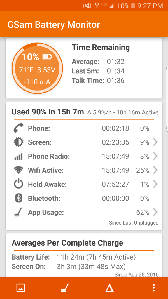

I have the S7 edge, and I really like the phone, but I got it because it was supposed to have amazing battery life. I got the phone, and get about 17 hours on battery (not bad) but with 3 hours of screen on time, I thought I was supposed to get 6+ hours? I have tried everything, clearing system cache, factory reset, turned off all the extra features that use the sensors, I even downloaded greenify and use doze on the go too. I just don't know what else to do. GSAM battery app indicates that my wifi is taking nearly 50% of my battery...but I don't know what to do about a wifi battery drain. I do text, snapchat, and groupme a ton throughout the day, but again, 3 hours of screen on time. I also lose about 4% per hour on standby, someone please help.
Screen shots with battery info is here: https://drive.google.com/open?id=0B72FMLAM5VX9cWRzQjh1anR6eFE

Where it says apps 62%, what apps are in there?

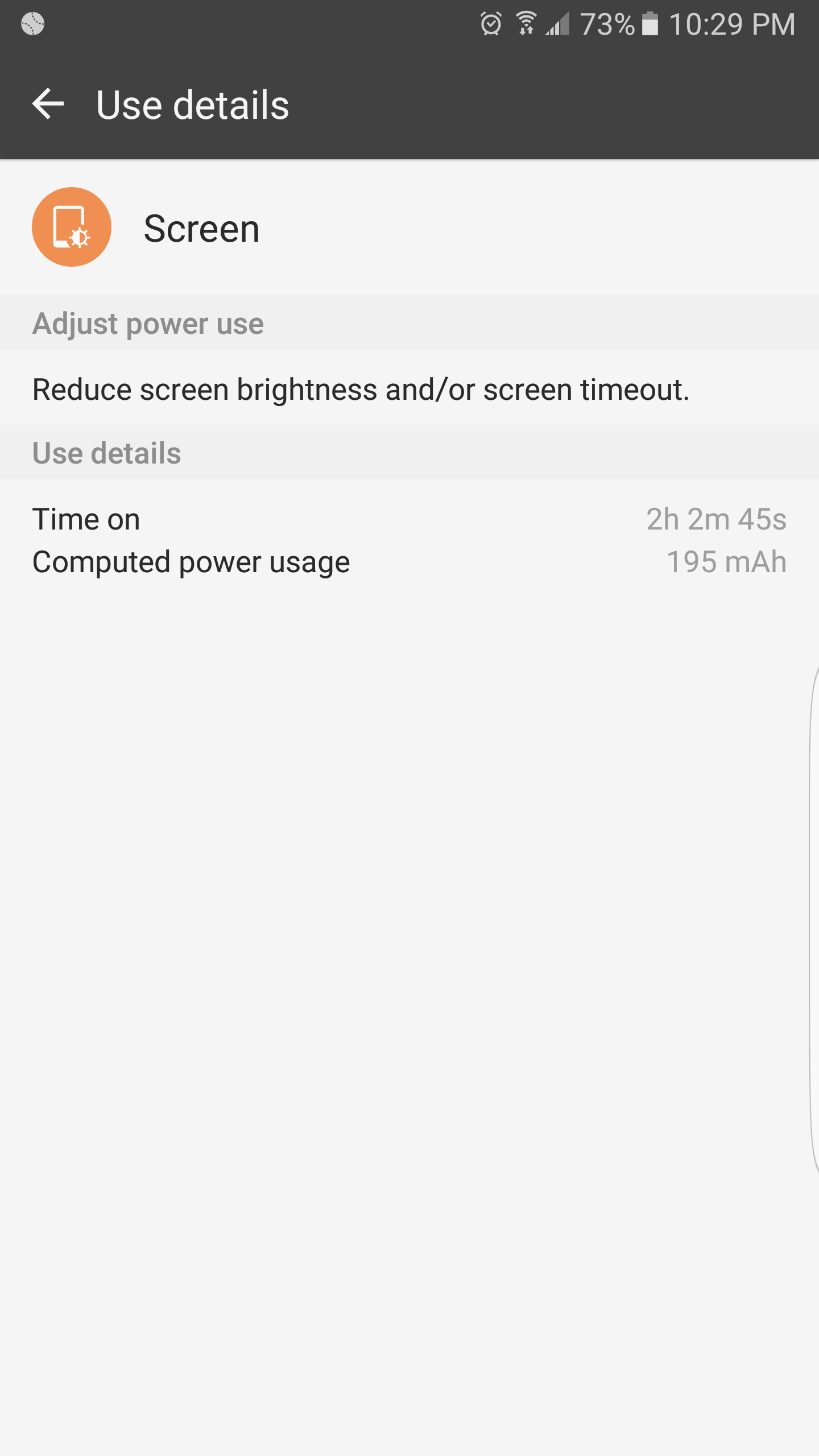

Im not sure whats running on your phone but Im at 73% right now with 2 hours screen on time. This is my 2nd S7 edge and both of them average 7 hours with bluetooth off.
Wow that is crazy! Okay at the end of today I'll give both. But I remember the top was android system and then android OS. there is no way I could have 73 percent at the end of the day with 2 hrs screen on time. That is awesome for you though!
