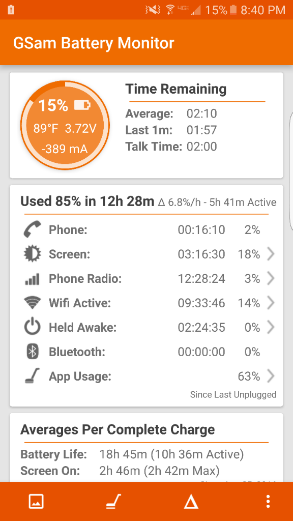

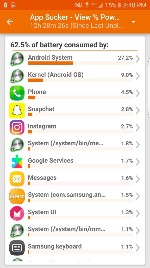

Ok first I wouldnt focus on the "android system" taking up 27%.From the look of your results it just means you didnt do a whole lot besides use the phone as a phone so to speak. Your screen on time however is not good at all. Right now I have almost the exact time off the charger as you but I have an hour more screen on time and double your battery (I streamed music for 3 hours so todays battery stats suck).
You say youve wiped the cache partition, did a factory reset etc etc.So that isnt going to help. What I do see though is your cell signal is low. Are you in a strong reception area or is it always below half? Cell reception will absolutely destroy your battery if its nonstop working to keep signal.
So you know, Im not trying to brag about my battery compared to yours. Just letting you know it is possible to get great life out of this phone, just gotta figure out whats causing yours to go nuts. I turn alot of stuff off because I dont use it so I'll give you an idea of my settings and see how they compare to yours. Remember, I dont use the stuff I turn off so some of these may not suit your needs. These are the settings that should make the most difference.

Edit: NM I just saw your other screens and your cell reception is full.
I dont know how long youve had the phone but if its me I exchange it if possible and if thats not an option I call Samsung. Youve done literally everything Ive done and your getting half the battery. Im at a loss man.
Ya my signal is usually never good. My home I have 2-3 bars. At work I have 1-2 tops. I work inside a school, in the data room with the servers and network switches. I'm a tech admin. I was only on the phone with Dell for like 20 mins today.
Id bet money its your cell signal then. Try turning off hd voice and see if that helps as well.

On your next day off use the phone similar to how you use the phone at work. Id bet you see a decent increase in battery life. Schools are notorious for draining batteries. I dont know what they do but as soon as I walk into my kids schools my signal dumps.
I think it's just the thick walls. And the roof blocking the signal. Tmrw I'd like to use my watch. And I should have 2-full bars all day tmrw. I'll post another one. I have a buddy who has the s7 edge I'll ask what his screen on time is. He is on verizon as well.
