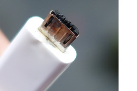

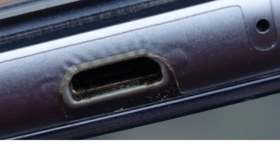

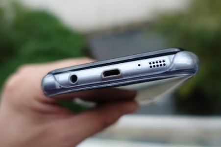

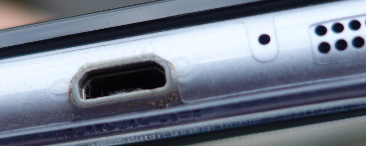

My s7e's USB port was fried when I had it for only 10 days, please see pictures.
After sending it in to Samsung for inspection, I got a inspection report email this morning:
"Thank you for contacting us regarding the problems you experienced with your Samsung product.
We arranged for the unit to be inspected by a Samsung Approved Service Centre
Once the engineer inspected the unit they noted that the water resistance test has failed caused by the burnt USB connector. The 5pin header of USB cable is burnt. There is dirt/dust and liquid residue inside the USB connector and cable. The speaker on rear case is damaged and melted next to the USB connector.
The engineer has concluded that the device has liquid damage to the USB connector which has caused a short circuit during charge resulting in heat and burns to the device and cable. I can appreciate that the S7 is advertised as being water resistant, however the product specialist has confirmed to us that the device has been found to be tampered with in some way causing the water resistance test to fail.
In situations where evidence of liquid ingress and/or physical damage is found, this invalidates the terms and conditions of the Samsung Warranty supplied with the unit as this is not a manufacturing/component failure.
The engineer has noted the unit is repairable.
As the results of this inspection are based on physical evidence as opposed to opinion we are unable to over-turn this position and we apologise for any problems and inconvenience that this process caused.
A service centre called Anovo will contact you with a quote, if you are unhappy with this you can contact them using the details provided with the quote to request the device be returned to you un-repaired.
I am sorry that we cannot offer a more positive outcome for you."
Below was how the port got fried and I posted that on xda some days ago...
"I put it on charge overnight, and I noticed it was switched off in the morning. So I switched it back on, there was a pop up message saying the phone had to shut down because of overheat and I saw the battery was charged at 100%. I didn't pay much attention and kept using the phone until that night when I tried to charge it again, I discovered the charging pot and the official cable tip were black and burnt. The phone wouldn't charge anymore and the usb connection couldn't be discovered on a pc either.
Please look at these attached pictures, it looks like it could've started a fire...
After searching extensively on the internet, I learnt that it was highly likely caused by water damage?! I don't understand why... it was dry and charging normally during the night. And even if it contacted water, the moisture sensor shouldn't allow it to charge, and it was charged to 100% and overheated."
I don't think the inspection report makes much sense. I didn't tamper anything and I don't think the speaker was melt because it was working when I sent it in.

Sorry for your damage. Are you sure there was no food or moisture on the connector when you plugged it in? Maybe a wet finger, drop of saliva, piece of pizza?
That particular connector has been in use on millions and millions of phones without problems.
Moisture is also my question. The OP has stated what happened except for how water got into the charging port. Also, would be nice to know how the engineer inspector determined the phone had been tampered with, which is apparently why they refused to honor the warranty.
I don't believe anyone checks the connector for moisture every time before charging their phone. I wasn't doing anything abnormal and I was charging the phone just like what I was doing every night. I only noticed the phone was shut down in the morning because of overheat (pop up message on the screen) and the phone was charged to 100%. Is it normal if there was a short circuit, the phone would still charge fully before frying the port? (I read in so many places that s7/edge has a moisture sensor, it wouldn't even charge if it was wet.)
I had xperia Z1 and galaxy s5 before, I even took Z1 to take pictures in the swimming pool, nothing bad has happened to those phones and I'm back with my s5 at the moment. I haven't done anything even close to what I did with those other 2 phones (it was only 10 days old, normally I wouldn't treat something new with dangerous actions) I actually took extra care of the s7 edge, got a full body protector, leather case and the clear case. I really don't believe Samsung could blame me in this case.
And, if you read their inspection report carefully, it doesn't even make sense. The way they are trying to blame their customer for all the faults makes me really angry. When I buy the phone, I buy the brand, buy the reputation and the customer service. Otherwise I could buy a similar spec Chinese phone for less than 1/3 the price. I thought I was buying Samsung like buying from Apple. I was wrong.
I wonder if he said "tampered with" because of the body protector right next to it?... Still doesn't make sense though...
I know the S6 has problems with the charger heating during fast charging, so maybe that affects the S7 too. Although Samsung states the problem is water damage related, it may be related to the fast charging epidemic. I'd press for a free replacement, especially since they market the phone as waterproof and you're well under the warranty.
I've heard too many stories already about Samsung denying warranty on the S7/S7E due to water damage. I can't believe a lawyer hasn't picked up on it yet. They advertise the damn device being used completely submerged in water for crying out loud. Most of their advertisements consist of getting the phone wet. But they will deny your warranty claim if their water resistance fails and ruins your phone. For this reason, my "water resistant" S7E will never even see a raindrop.

Have you put the phone in water prior to this happening?
Plus the charge port looks mighty dirty and hairy. :p
The department that handled this issue was too stupid. They will loose a lot of customers if this story spread on the internet. It would be smarter business decision to just replace the device.
Sounds like water got into the phone by their description and this is what caused the fault. The phone is water-resistant, not waterproof. You went swimming with your other phone, did you also go swimming with this phone? I look upon the water-resistance as insurance, not as a Gopro type camera.

My 2 cents worth, I notice in your first post you mentioned Anovo, These are the repairers O2 use and from reading the discussion boards over there its a known joke that anything you send them is always down to water damage and thus not covered. even the mods over there recommend that nothing goes to them.
I actually think it got more hairy and dusty after the port was burnt.
unfortunately, I learned it was ANOVO after posting the phone to them. I was tracking samsung repair on Samsung website, and ANOVO's contact details were given...
I knew they had a bad reputation, and I knew for sure that when I sent it in, the speaker was working fine, it wasn't melt. Because I bought a wireless charger to use it for a few days after it was fried.
