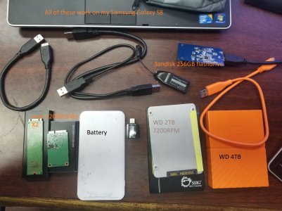

I use a WD 4TB Orange My Passport Portable External Hard Drive - USB 3.0
I drains the battery quick tho.
I would recommend an SSD or use a external drive enclosure.
I use Siig USB 3.1 to SATA 2.5 External Hard Drive Enclosure
With Various HDD and ssds It has a Y splitter so it wont drain your battery.
If you want to go smaller Kingwin USB 3.0 to NGFF(M.2) SSD External Enclosure Adapter
Or
Kingwin USB 3.0 Mini SATA Enclosure Adapter
A SanDisk Ultra CZ48 256GB USB 3.0 Flash Drive does very well and is very portable.
All of these work well, You will have to format them to exFAT first.
