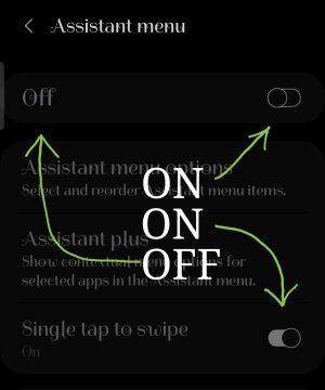

I used to be able to answer calls from the lockscreen but then it stopped working. You may need to enable the following after the last update. Go here and: Turn on, set "single tap", then turn off (unless you want the floating menu).
